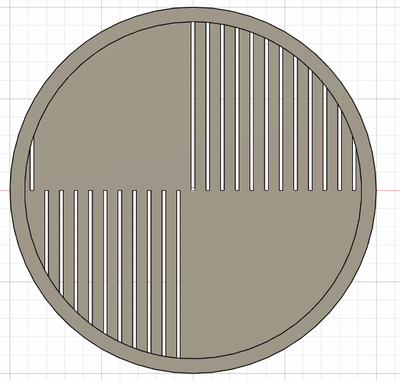

I am trying to recreate this object as a parameterized model, but I am having trouble with patterning. As you can see, it has vertical slots that vary in length based on the curvature of the outer circle.
I can create a rectilinear pattern of the 2-corner rectangle in the sketch, but when I go to extrude, I always have to select the faces to extrude. (This is how I got the original picture.) Thus, adding in parameters that change how many copies are made in the pattern operation breaks the extrude.
I can create a rectangular extrude cut from a rectangle with corners tangent to a sketch circle and do a rectilinear pattern on the extrude. While this works better with parameterization, the new cuts don't respect the tangent.
Is there a better way for me to go about this?

Ah, so the problem I was running into was caused by a few things that you solved @g-andresen .
  1. I was extruding the rectangle upwards from an XY sketch rather than from a XZ or YZ sketch.
  2. I was trying to extrude a rectangle using total distance. You instead showed me that I had to extrude twice, with each segment set to extrude-to-object.
  3. I was using the extrude-join method rather than the extrude-new-body method, which combined the extrude with the outer ring; not what I wanted.
This solved my initial problem, but now I am left with a bunch of bodies.
I can select all the bodies (the ring and the newly formed slats) and combine them into one body, but every time I change the number of patterned objects to create, the combine feature breaks. Is there a way to select all bodies created by the pattern feature programmatically/parametrically?
