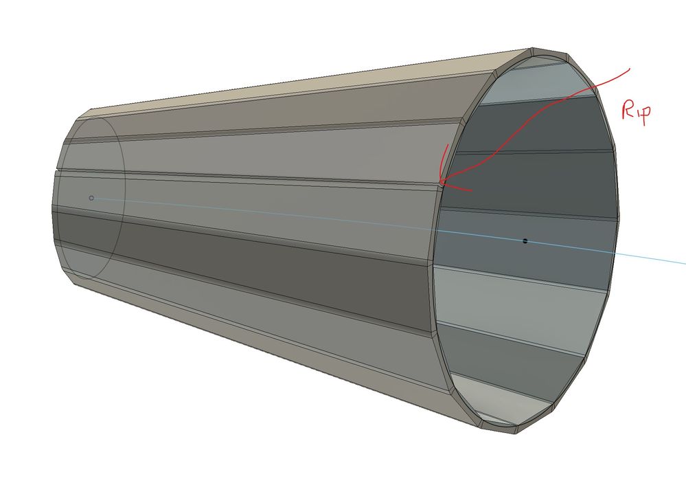

Hello guys,
I’m designing a two stroke pipe at the moment. Now I got the cones and angles right where I want them to be, but I don’t get how to unwrap them so that I can print them out to try fit or laser them. Some times it works and sometimes don’t. I’d appreciate to get some help from somebody.

It would have helped if you kept the rules for sheet metal in mind during modeling, but it will certainly work if done correctly.

TheCADWhisperer
Make conic surface with at least minimal planar surface and then trim the top and/or bottom as needed.

gajdostudios
Community Visitor
Community Visitor
You must make sketch of every cone but without end angles just straight cones and then you revolve them in surface menu to 359degrees then you make flange in sheet metal menu but u must have choosen the rule so like sheet metal 0.8mm or whatever u need then you must thicken the cone and select the joint then you make lines where u need angles and then you select that lines and make new angled faces then you make a lot bigger circles on that new faces and last step you extrude that circles like u cut the cone in outside direction but u need to have in mind that you can make cones just one by one

Sheetmetal Lofted flange (Brake Press) and Rip will get you very close.(Quickly)Screenshot 2023-11-13 133428.jpg
