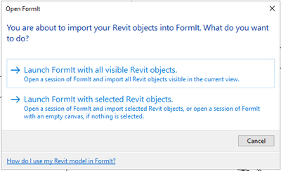

Make sure you're in a 3D view and the "FormIt 3D Sketch" button is active (F is blue, not gray).
When the "FormIt 3D Sketch" button is clicked, you should receive the following dialog in Revit:
Do you see this dialog?
If so, which option are you selecting to Launch FormIt with?

Yes, I did all that and I tried both options.
