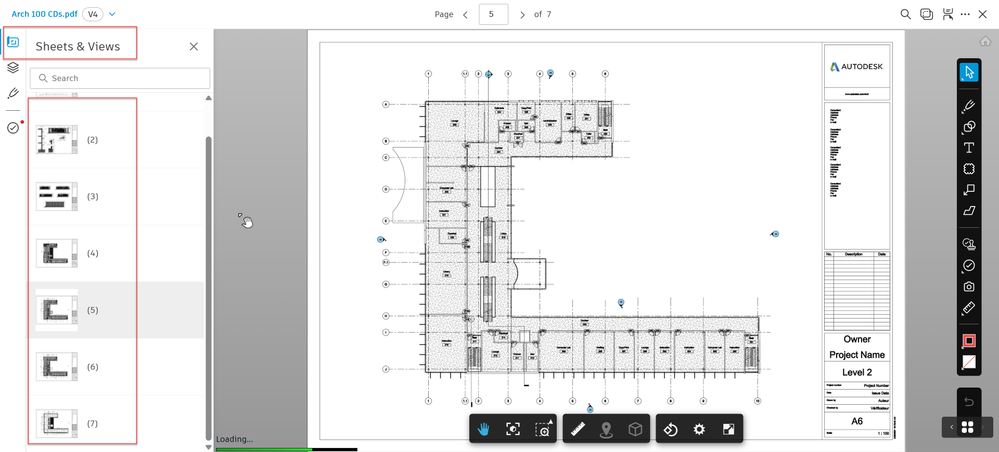

The company receives a PDF file containing the sheets, and those sheets have page numbers based on the number of pages in the PDF (1, 2, 3, etc.). In the example below, notice that A6 is page number 5:

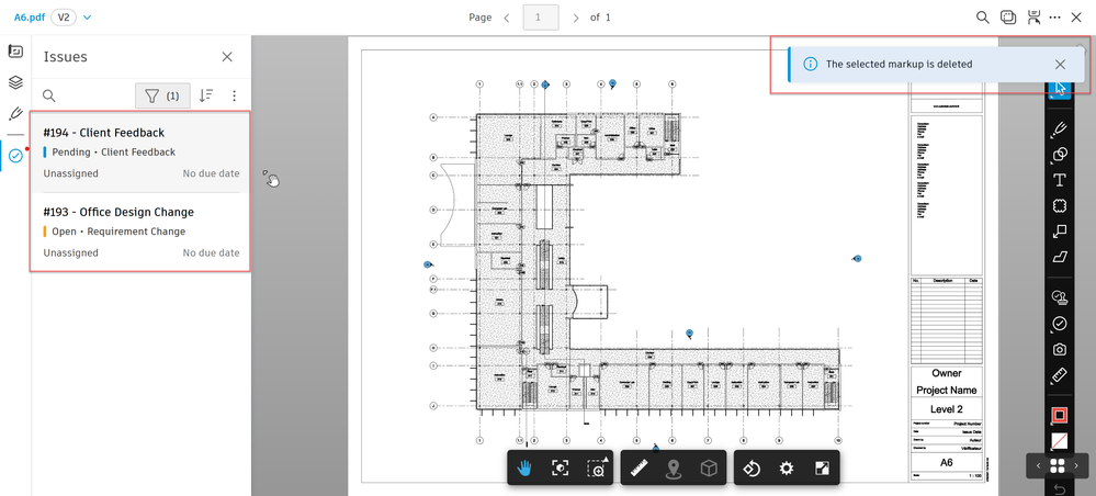

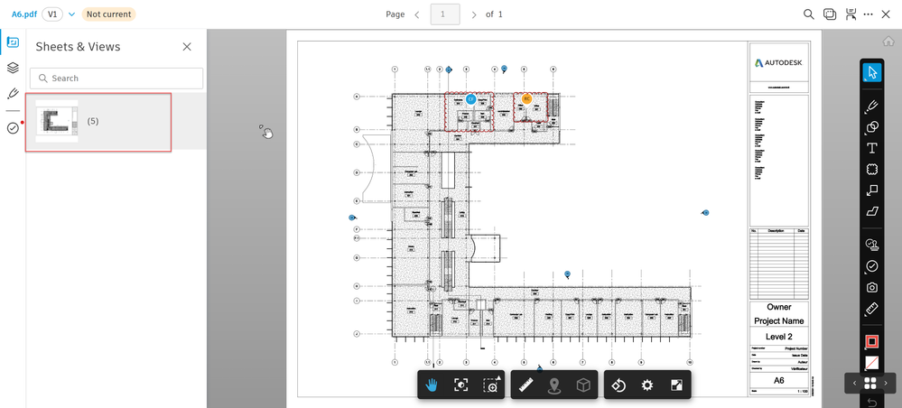

However, the page number within that sheet seems to be causing the problem, and the issue pins are disappearing. Notice how the issue pins disappeared from A6 file V2 because the page number is different now (2) instead of (5), although the issues are still there (but not the pins):
Autodesk Docs’ current PDF pin system is page-based, not file-based, and the request would be to have it similar to Build Sheets, where pins are bound to the published sheet.
