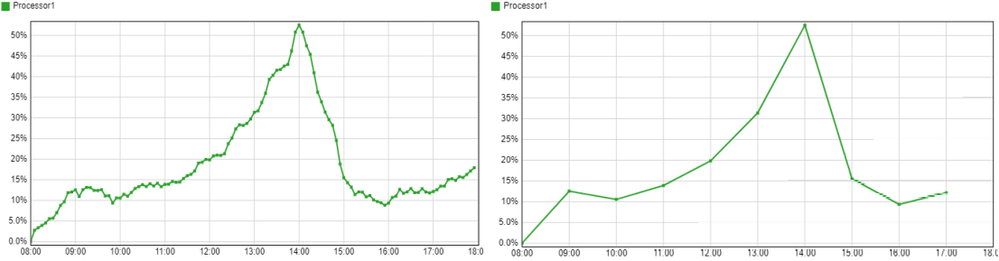

- NumSubIntervals determines how often that measurement is actually taken. In the example image above (and the attached model) the collector measures the average utilization over the last 3600s 12 times within that interval of every 300s. Each meausurement still denotes the utilization over the complete "MeasureInterval".
The graph on the left takes a measurement every 5 minutes, the one on the right every 60 minutes. Each point on both graphs represents the average utilization over the previous hour from that time point in time.
