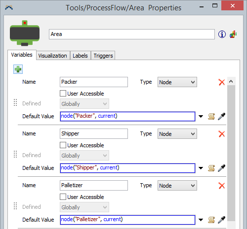

This is where Process Flow Variables come in. In the example model, you will find the following Process Flow Variables:
Every staging area has a Packer, a Shipper, and a Palletizer, each referenced using the node command. Remember that current is the instance object, which is the Plane. Once these variables are in place, you could create an FR Flow like the following:
If you ran this model with the Plane shown previously (complete with correctly named objects) and this flow with the shown variables, then the Packer operator would travel to the Palletizer. If you then copied the Plane, you would see that all Packers go to their respective Palletizers, as shown below:
