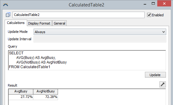

Group Utilization
To make the final utilization chart, make a second calculated table. The query for the second table should be as follows:
SELECT
	AVG(Busy) AS AvgBusy,
	AVG(NotBusy) AS AvgNotBusy
FROM CalculatedTable1
Again, use the Update button to be sure the query is correct. Once it is, set the update mode to Always.
Finally, you can make the pie chart for this data:
