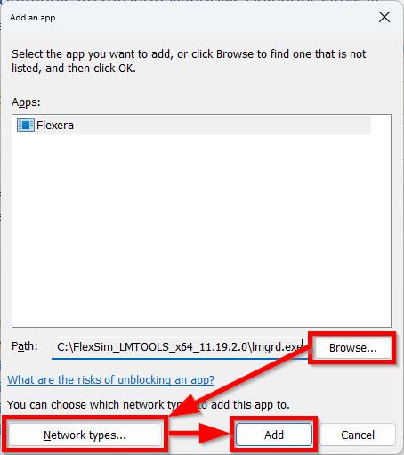

Add a firewall exception for lmgrd.exe
In the Allowed apps window, click the Change Settings button, then the Allow another app… button.
In the Add an app window that opens, click the Browse… button. Navigate to extracted license server downloads. Double click lmgrd.exe to choose the file.
Click the Network types… button.
Check the boxes for the various network types that the firewall should allow. We recommend allowing your FlexNet licensing to communicate across all network types, but contact your server or network administrators if you're not sure.
Click Okay to close the Choose Network Types window.
Back on the Add an app window, click the Add button.
