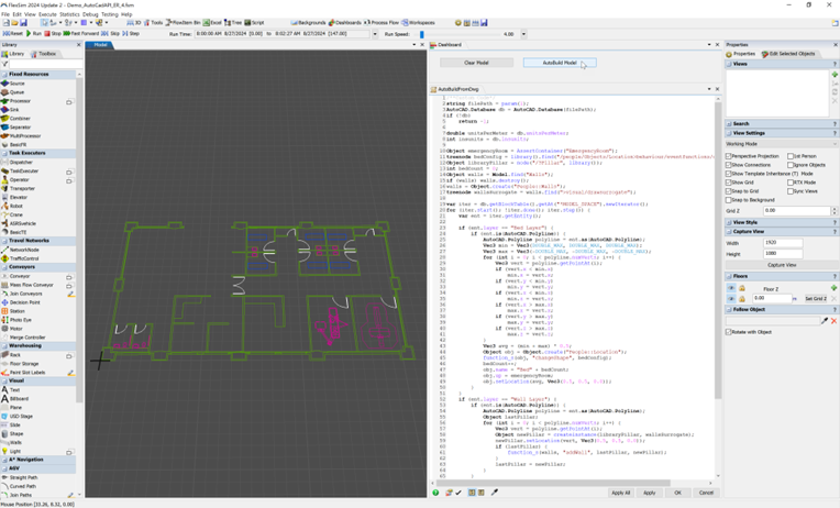

Using the new AutoCAD FlexScript API, the data within dwg files can be read using FlexScript to automatically build simulation objects within the model.
The script in this Healthcare example is contained in the AutoBuildFromDwg() user command in the Toolbox. This command reads the average location of blocks on the Bed Layer to create Bed Location objects. It also reads the lines on the Wall Layer to automatically create Wall objects and connect them to the A* Navigator for automatic pathfinding around the walls.
string filePath = param(1);
AutoCAD.Database db = AutoCAD.Database(filePath);
if (!db)
return -1;
var iter = db.getBlockTable().getAt("*MODEL_SPACE").newIterator();
for (iter.start(); !iter.done(); iter.step()) {
var ent = iter.getEntity();
print("Entity:", ent.layer, ent.objectType);
if (ent.layer == "Bed Layer") {
if (ent.is(AutoCAD.Polyline)) {
AutoCAD.Polyline polyline = ent.as(AutoCAD.Polyline);
}treenode bedConfig = library().find("/people/Objects/Location>behaviour/eventfunctions/configs/Bed");
Object obj = Object.create("People::Location");
function_s(obj, "changeShape", bedConfig);Object walls = Model.find("Walls");
if (walls) walls.destroy();
walls = Object.create("People::Walls");
treenode wallsSurrogate = walls.find(">visual/drawsurrogate");
Object libraryPillar = node("/?Pillar", library());
Object newPillar1 = createinstance(libraryPillar, wallsSurrogate);
newPillar1.setLocation(0.0, 0.0, 0.0);
Object newPillar2 = createinstance(libraryPillar, wallsSurrogate);
newPillar2.setLocation(10.0, 0.0, 0.0);
function_s(walls, "addWall", newPillar1, newPillar2);Object walls = Model.find("Walls");
Object aStarNavigator = model().find("AStarNavigator");
if (!aStarNavigator) {
aStarNavigator = createinstance(library().find("?AStarNavigator"), model());
Object grid = aStarNavigator.find("Grid1");
if (!grid) {
grid = function_s(aStarNavigator, "createGrid", 0, 0, 0, 1, 1, 0);
grid.name = "Grid1";
contextdragconnection(grid, walls, "A"); POC_OHT_3_MoveOHB.dwg (If this file is named differently when you download it from Answers, make sure you name it back to this exact name. It is referenced by name in the model.)
