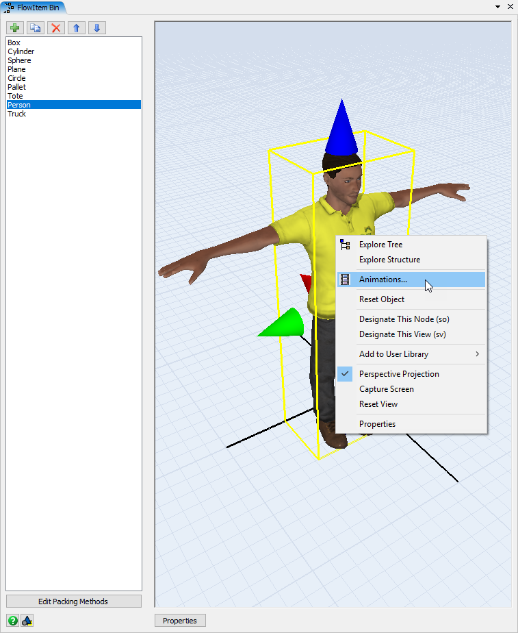

6. In FlexSim, edit the Animations for an Operator or a Person flowitem:
