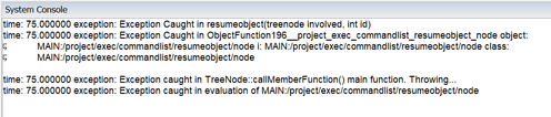

In the attached model, TE stops according to the timetable for only one minute, from 08:00:15 to 08:01:15, while unloading.
The unloading time is set from the TE's property.
  • When the stop time is shorter than the unloading time, the following error occurs.
    (Exception Caught in resumeobject()~)
  • When the stop time is longer than the unloading time, TE continues unloading even though it is stopped.

Is the above behavior a bug?
To avoid these behaviors, is the only way to reproduce the unloading time in the process flow by using a delay?

Hello @yoshinaka_yuito,
We have reported this to the development team for further investigation. We unfortunately do not have a workaround for this.
