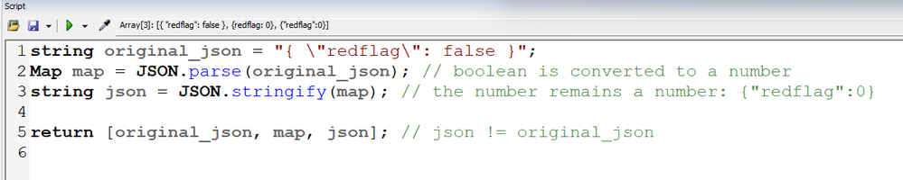

In Flexscript it seems to be impossible to generate JSON with boolean values, such as `true` and `false`, which are required by some 3rd party protocols. Conversion JSON.parse -> JSON.stringify is lossy.
I think this example explains the issue:
I suppose that the issue can be resolved if Flexscript had a `bool`  type, similar to `int`, and it was also a distinct `Variant` type, so it can be stored as a binary flag within Maps and Arrays. This would allow JSON.stringify and similar methods to generate correct output.
