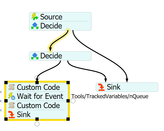

I've created an object process flow, that triggers when a box covers a PE. Based on some conditions, the box stops or sinks. The box resumes when a model variable reaches a threshold. I've managed to resume the object after a time, but I'm don't know how to write a variable-based condition.

Thank you both for the examples. I think I didn't express myself correctly or I'm not able to interpret them right. I achieved to make a decision based on a variable. What I'm struggling with if with resuming the item once the condition that made it stop changes. In the example that I upload, what I want to stop the object in the first PE and only resume it when the number of items between the PEs is less that 2.

This will work if you use a tracked variable instead of a global variable. The tracked variables can be referenced in a wait for event.

Is there a way to wait until an event (as in the example) but with 2 tracked conditions? I have to decides and I want to resume when one or the other condition is met.

You would need a wait for event for each variable. In the model provided you can see how I implemented this.
