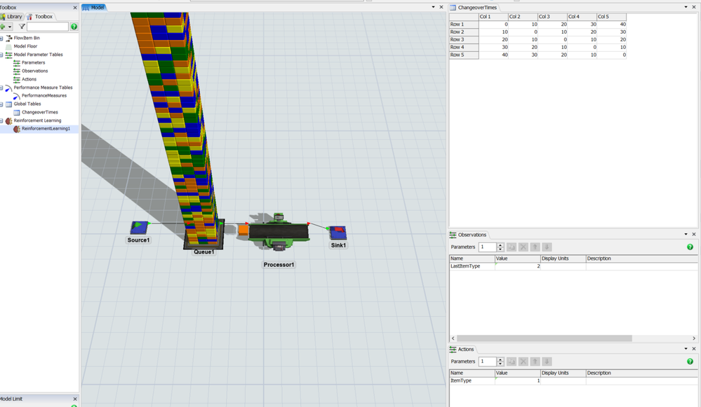

I am trying to simulate model with AI using reinforcement learning. I am following your tutorial of flexsim 2022 (https://docs.flexsim.com/en/22.1/ModelLogic/ReinforcementLearning/Training/Training.html) . But I am facing issue in python It cant able to fetch observation data. It did not update further value.

I've reviewed your model and it appears that it should be working perfectly. However, it seems there might be a bug causing the issue you're experiencing.
I'm sending you a modified model that resolves this problem. I believe this is a better approach and I highly recommend it. The problem lies in the Decision Events within the Reinforcement Learning tab. We’re going to delete them all (as they seem to be failing) and we’ll call the RL from another place.
The solution involves using ProcessFlow to create a token each time an event triggers, and then calling the RL from a customCode. The default code for this is located in control. After this, we remove the token.
I hope this helps!
changeovertimesrl.fsm
