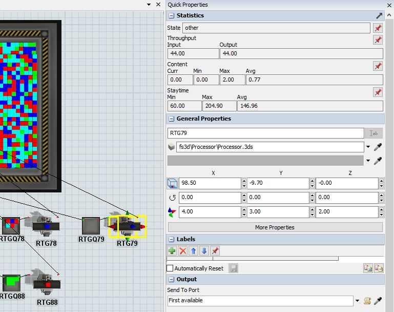

There are 2 processors with identical process flow, namely RTG79 and RTG88. RTG79 has no item to process so it should be in "idle" state, while RTG88 has 1 item to process so it should be in "busy" or "processing" state. However, their statistics states always show "other" then I can't generate a gantt chart. How to resolve?

Hi @John H4, please be so kind and add your model or small example model. It isn’t possible to guess what your process flows do or how your logic works from pictures alone. Many Thanks! Regards Jörg

only the 3D objects set their states automatically. From what I read in your post, you are using a processor based on a Process Flow template (model would have been helpful)? If so, you will notice that the PF does not implement states, you will have to add those yourself.
