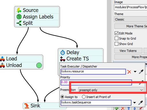

I have a question about creating a preempt task in process flow. I use Create TS to create a preempt task. But the result is that this task isn't a preempt task. The details are shown below.

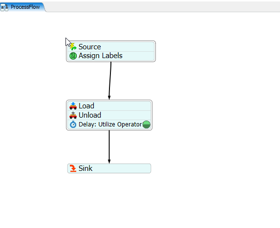

Instead of using a preempt task you would want to use a Delay for the operator to go into a Utilize state during the unloading. Here is an example. I have also attached a model below.
12572-delay-utilize-operator.pngdelay-utilize-operator-model.fsm

Thanks for your reply. Actually, This unload task includ a travel task .I want insert a preempt task(a unlited task) during the operator on the way to unload.

Hi @tong
Change Executer/Task Sequence to "token.taskSequence"
Message 10 of 10
tongsw
The problem has been solved. Thanks very much.
