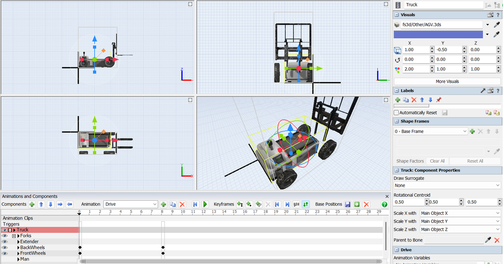

Hi, I'm working on a model that works with AGVs, is there a way I can introduce "lift speed" to the AGVs as if they where normal forklifts?
I thought of using just regular forklifts but I want them to look similar to the AGVs

You can replace an AGV by a transporter. Edit. It is up to you to adjust a shape as you like. I would start to set unnecessary components in a animation creator to be invisible.

In the model you can see that I already changed to "normal transporters" how can I shape it as an AGV?

The transporter consists of multiple surrogate objects, so they can be animated independently from each other.
As Jörg said, I would start by going into the animation editor (right click -> Edit -> Animations) and hide/change some of those shapes.
Replacing the "Truck" shape with the AGV model and hiding the "Man" ends up like what you see below, for example.

Thank you for your answer @Felix Möhlmann, mine is getting like this:
The other elements don´t change. Should I sized them to match the body?

The components will adjust their size based on the size of the main object on reset. See the "Scale _ with" options in the lower right.
