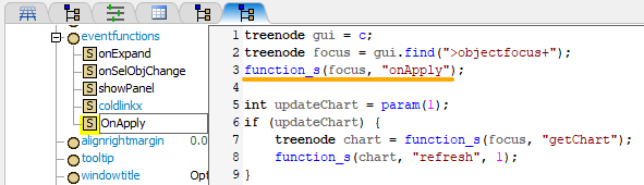

You can find stuff like this by exploring the GUI elements. In this case, when selecting a table from the dropdown, the following code is executed:
"applylinks" sets the node value in the "replacements" to the selected table. For the second line we traverse the tree up to the node on which the function_s is called ("c" is the GUI element for which this function is defined, i.e. the next object node above the function node).
This in turn executes the "onApply" on the focus object which is the chart node.
