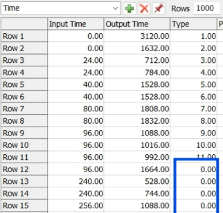

Hi, good afternoon
When I check output result , I found some bug in my model.
I set Item Type in source input, and use queue's onEntry to Increment Value.
But, the Item type wasn't correct to write to global table.
Can you help me to fix it?
Thanks.

jason_lightfoot_adsk
Try itemtype(item) as the thing to increment.

joerg_vogel_HsH
Names are strings. Strings are case sensitive. “Type”, “type” and “itemtype“ are different names.
