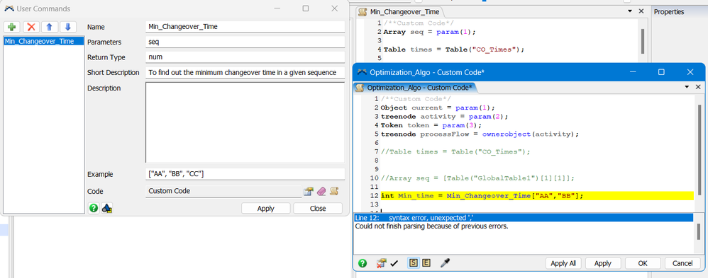

Hi Team,
I have created a user command and passing array as a parameter. But, it is showing errors while calling the user command.
Could you help me to know where it is going wrong?
Thank you!

Here's the documentation - you should use "var seq" in your list of parameters.

Before, I was using Array seq = param(1); while defining user command.
Now, I made the correction as below:
var seq = param(1);
Even I am getting the same errors while calling the user command as
int Min_Time = Min_Changeover_Time([1,2,3]);
It is not accepting array as a parameter.
Do I need to change anything else?
Thank you!

The Array type is correct in the code but not in the parameter definition of the user command where you must use 'var' or Variant.
Example attached.
