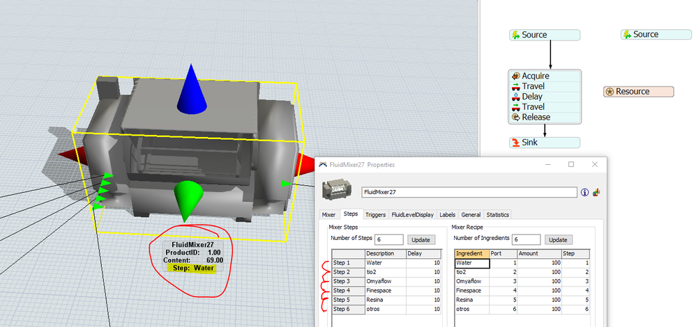

2.fsmI am using a FluidMixer and I need to generate a token when changing the step, this to be able to identify what type of material the FluidMiexer is receiving and thus make a motion decision.
I hope you can support me.
Regards

Hi @Roberto S6,
In this updated model, I have a line of script that creates a new token using the After Step Delay Trigger. It should work for what you need, but I'm not a fluids expert, so let me know if something goes wrong.
In the example, the trigger is fired after each step and the token is created at a "Start" activity, which can then be used to run a sub-flow. You can pass in other variables by modifying and adding to the script. Hopefully this helps answer your question.
create-token-on-message.fsm
