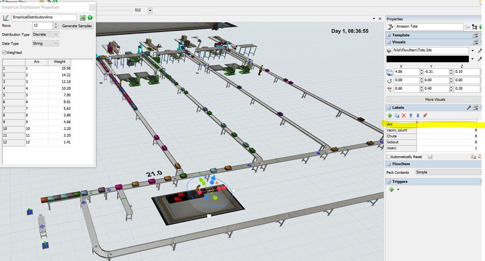

Hi, I am trying to model the induction of totes into a conveyor based on a forecasted probability (weight).
So far I am using the following empirical distribution:
Now, I would like to add in variability in terms of the number of consecutive totes for the same arc that go into the conveyor.
In other words, I would like to have parameters that increase/decrease the probability of having more/less consecutive totes for the same arc:
for example:
1-4-6-1-3-1-6 vs 1-1-1-4-6-6-3
does anyone have any ideas on how to model this?
In my head the expected behavior would be something like this:
Thank you in advance,
Lambert

jason_lightfoot_adsk
The weight give the increased chance of having two consecutive totes on the same arc if you're sampling for each tote.
If you're sampling for a each slug of totes going to an arc, then you can do that in a seperate lookup but then sample less frequently from the the empirical distribution. That then mean the empirical should represent the spread of consecutave totes and not the total spread of totes, meaning you data should be changed to reflect that (if it's the spread of totes currently).

Hi good morning,
could anyone tell me how to add some variability to a Empirical Distribution?
I'd like that with each replication of the simulation it takes different values.
For example, for Arc 1, instead of a fixed 15 weight, i'd like to use Normal (15, 2) that varies with each replication
Lambert
Message 6 of 15
FelixMoehlmann
You could set the distribution weights in the model reset trigger and use a global table to store the respective distributions (make sure to 'Assign FlexScript Data' to the table cells).

This will of course only yield different results, if the 'Repeat Random Streams' option is inactive or for different replications of the experimenter.
Variable_EmpDistribution_fm.fsm
Please consider posting a new question the next time, if it doesn't directly relate to the topic of the previous one.
