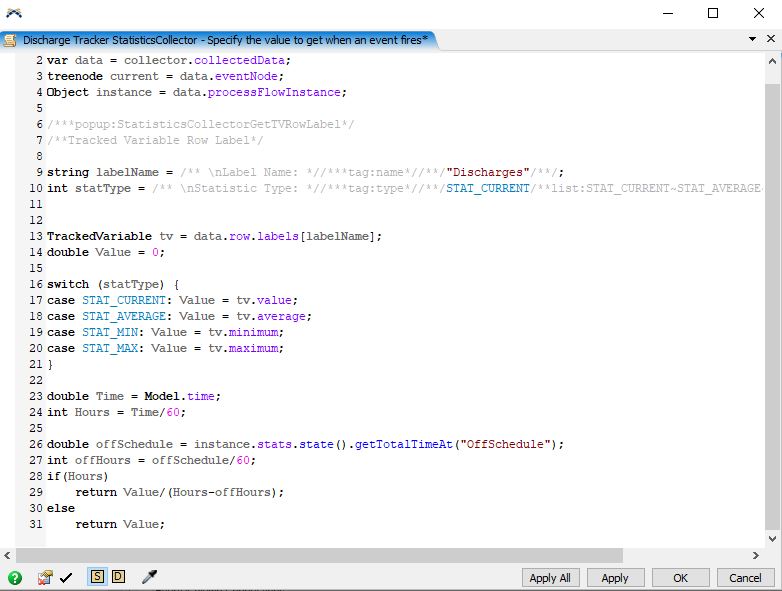

I need to code this calculation inside a statistics collector. What I tried is instance.stats.state().getTotalTimeAt("OffSchedule"); but it is not working. I dont know what specific code I can write to acess that number.
jose_andres_ca
This is a picture of what I am trying to do.

"OffSchedule" is part of the HC state profile, which you have to signify in the "state()" command. Otherwise the default profile is used.
instance.stats.state(2).getTotalTimeAt("OffSchedule");
The code in the script console at the bottom in my attached model should also work. Only the reference to the staff member needs to be adjusted.
Table.query("SELECT [OffSchedule] FROM [StaffStates.StatisticsCollector] WHERE Staff == $1", StatisticsCollector.getID(staffReference))[1][1];
