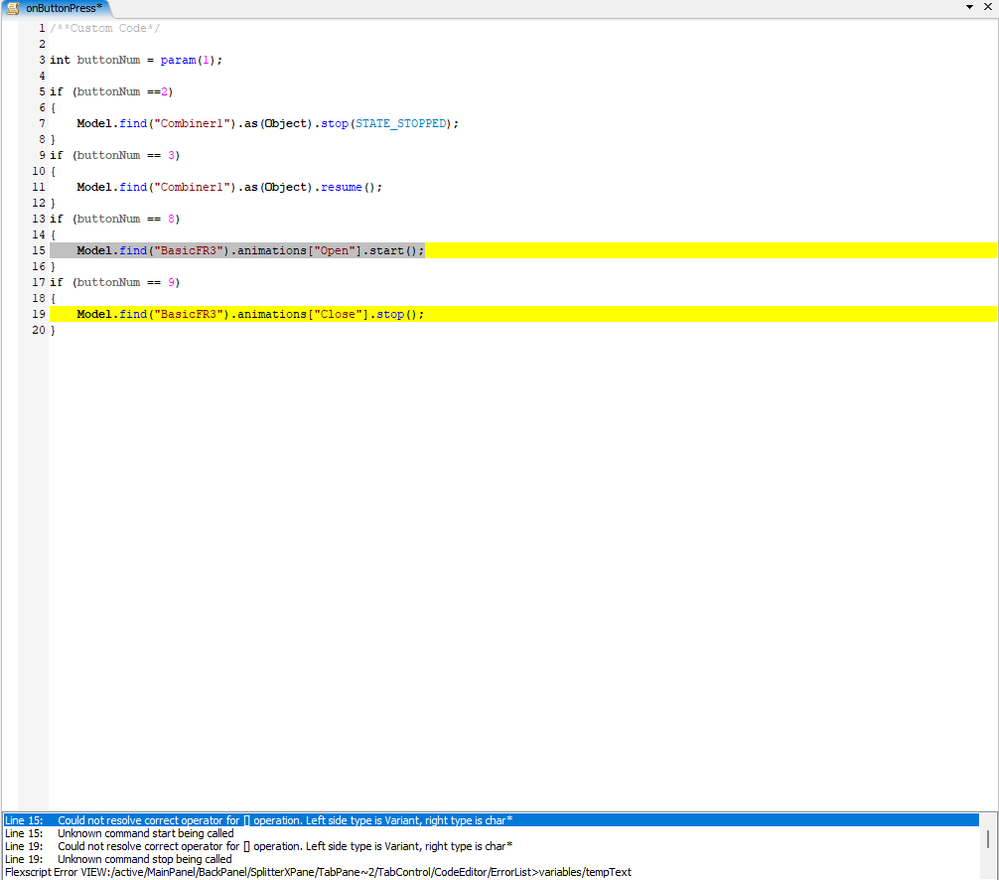

sri_vikas_k
moehlmann_fe
In your screenshot you are mixing up two ways to access the animation.
You can either use the old commands (startanimation, stopanimation, ...) which you can look up in the command help within FlexSim directly (Help -> Command Helper).
Or you the newer "animations" class. Information about that is available in the class reference section of the online manual.
https://docs.flexsim.com/en/23.0/Reference/CodingInFlexSim/FlexScriptAPIReference/Data/Animation.htm...
If you need to look up syntax in general, those two sources will help you in most cases.
sri_vikas_k
I have tried in that way also, but it is still showing the error.
moehlmann_fe
Try placing "as(Object)" after "Model.find()" like in the 7 an 11. This tells FlexSim what to interpret the node as.
joerg_vogel_HsH
@Sri_vikas K, “find” method is of a flexscript class treenode. The class “animation” is a sub class of class Object. Felix showed a method of casting from one class to another class.
