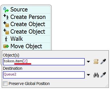

In this process flow, person with two objects will be generated from a single source, person must travel to a location(Queue2) & drop a bag and should travel to another location (Queue3) and should drop another bag there.

You need two references to the created items. You can set two different label names or you put the references into an array.
When you move the object you must distinguish between the first or second reference in the array of token.item.
and the other reference
If you don't need the references of the items in the array of token.item you can always return the first reference and eliminate the entry by shift().
token.item.shift()
