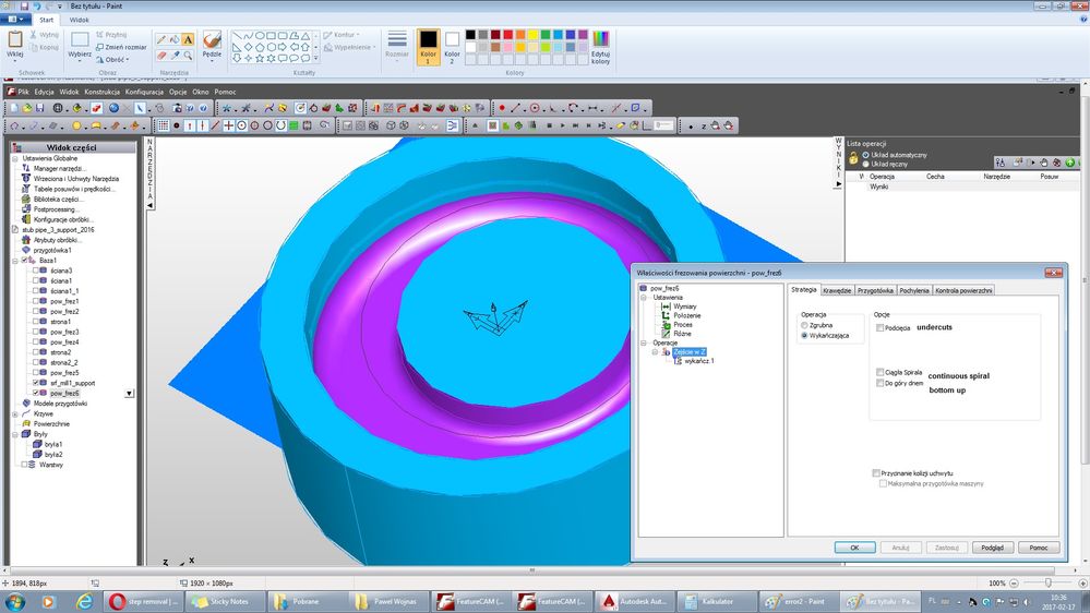

Hello everyone.
I have problem with uncut surface by using cutters with radius.
Namely. I choose surface (here radius) to milling and it comes (cutter) to surface boundary and stops. It leaves uncut place which has radius of cutter. If cutter had no radius on the corner it would be correct, with no uncut place.
I'm looking for answer how exceed boundary with cutter (with radial corner).
I've tried parline and add bottom milling (add new strategy) and the same.
You can see on the second side is correct (bigger radius)...
Thanks for help.

Hi @Anonymous,
Welcome to Autodesk Community!
Is the ball end or bull end radius of cutter is same as radius on surface? This may be the reason the tool is not cutting on that particular region and leaving material. Have you tried surface milling feature? There are many options in 'Edges' tab to specify how the tool behaves at the edges of the surface.
But to be honest, I will be more clear if I can get a chance to see the toolpath in fm file. Is it possible for you to upload a fm file?

Radius is 15 and cutter is 20 R10.
Why not. I put it in attachment.
I think that cam (shape) is reason. FeatureCAM detected a collision, because i can read :Your tool diameter 20 is too big. Use  max. diameter 0,00004.

I have created a surface milling Z level feature with Interleave spiral paths and restricted it with a circular boundary in stock tab/ select curve for boundaries. I have also verified the simulation results with part compare and found no step. Can you please take a look in the attached fm file and let me know your thoughts?

I'vew tried use your curve and select curve for boundaries, surface feature with Z level, pocket 3D (kieszeń 3D), boundary curves - circ1, islands curves - nothing (maybe here is problem?), method of restriction: point of contact and nothing changed ;/ Still using 3D model boundary.

It's great helpful movie, but there is no interleave spiral paths in strategy (in my version)
It must be reason of no operations in program tree.
options.jpg. It must be new part of 2017 version.

Ahh! Ok. If there is no option 'interleave spiral paths' then you can add another process in existing Z level finishing, that is 3d spiral and use the same boundary. Refer the attached fm file. Hope that will work.

I dont know why spiral 3D is not active in my program.
But I've tried with spiral 2D and it works!  I put it instead Z level strategy
Result up(I have set 0,02 mm tolerance to show blue material, so it's doesn't look good, but it's great result).
I think its answer to my question and for more in the future to the similar things.

Spiral 2D and milling inside. And select boundary.
