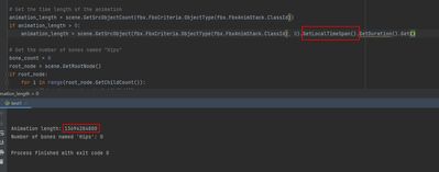

This error is encountered when obtaining the time length
animation_length = scene.GetSrcObject(fbx.FbxCriteria.ObjectType(fbx.FbxAnimStack.ClassId), 0).LocalTimeSpan.GetDuration().Get()
AttributeError: 'FbxAnimStack' object has no attribute 'LocalTimeSpan'
410299258
I need this
time length = (get end - get start)/get fps

I tried to modify this, but the value I got was not what I wanted
