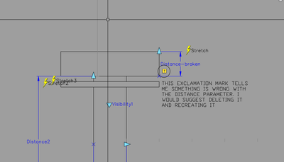

Thanks for reply. For comparison: EstStairs300.dwg is unaffected, EstStairs300-1.dwg has an additional parameter and action that is affected, Random Block.dwg does not work at all (doesn't show any Dynamic Block grips).
h_s_walker
@mloszakiewiczYCWJX See the image below. The text is the same for your Random block as well, both distance parameters have the same exclamation mark. The problem is you have used the basepoint of the distance parameter as your start for the stretch. Delete the stretch action and this time use the actual point that you're going to stretch.

It worked. Thanks.
