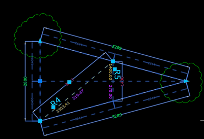

I have a problem using the polar stretch parameter and polar stretch action in my dynamic blocks
This is the original shape of my block:
I added two main parameters to modify the length and the width of the block as shown in the next two green clouds:
Another secondary polar parameter is chained to the main two parameters  to move the line marked R4 and rotate it automaticly to result the follwing:
This is the hoped result so that the mark and the line lenght and the angle are parrallel as shown
also the point for stretching its dim line should be at the middle of the mark as shown.
unfortunatly the result is as the following:
I attached the block

Message 2 of 23
j.palmeL29YX
Using a block with constraints you can do >>this<<
- change the value of d1 to 4000
- change the value of d2 to 6801
- change the value of d3 to 2000
Your R4 is not necessary for such modifications.
BUT I'm not sure which values you really want to "drive" the geometry.
Do you really want d2 or (perhaps better) the horizontal width of the shape?
Do you want drive this three dimensions or do you want as result, that the R5 line always touches the both lines at the midpoints? (Then is one of dimensions d1, d2 or d3 not necessary. It's your choice which of them you delete).
Your description leads to an over constrained geometry: If d3 is always the half of d1, then the R5 line will touch the both lines always in the midpoint (regardless of the length of d2).
You should exactly define, which values you want free to change, and think about, which values are the geometrical result.
Please clarify ...

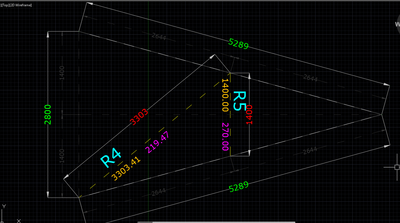

in the meanwhile can you please explain why The Attribute named (R4) and the 2 fields below are not rotating correctly with the line???

Message 6 of 23
wael6URAQ
Many Many Thx
Message 7 of 23
wael6URAQ
THANKS ALOT
NOW THE ATTRIBUTE TAKES THE LINE ROTATION PROPERLY
BUT NOW THE ATTRIBUTE IS FIXED
IS THERE A WAY TO BE ABLE TO MOVE THE ATTRIBUTE  RIGHT LEFT UP DIWN LIKE THE POINT PARAMETER WITH MOVE ACTION LIKE WHAT I USED IN MY ORIGINAL BLOCK??

j.palmeL29YX
I think now I understood what you need. >>Click<<
Have a close look at the attached file to analyze what I did. I hope you see the principle, even if I added only the "actions" for two of the attributes.
(After changing the Length and/or the Width you must of course regen the file to update the values of the fields. The attributes are rotated in a correct manner. With the point grip you can/must move the attributes to an appropriate position.)
For a better compare of both blocks my block patest-3 still includes your old geometry. And I did not yet change the constant property of my attributes to yes. but I think such trivia you can correct yourself.
Jürgen Palme
