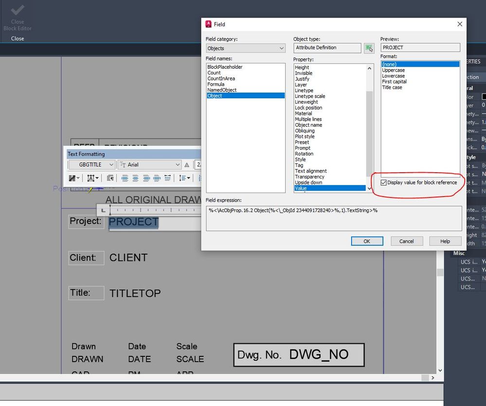

I have a block of an electrical module. In the bottom right corner, it includes four attributes for four different effects. In the top right and left, those values are repeated using "Field" commands linked to the attributes. I configured them using the "Field" > "Object" > "Value" method. However, when I use the block and update the attribute values, the Field entries don't reflect the changes. I already tried using the REGEN, ATTSYNC, and FIELDUPDATE commands, but nothing seems to make them refresh.

Fields will not update within blocks until you have performed a single dynamic action.  Your block does not contain any dynamic parameters so you obviously have not performed any dynamic action.  Only one action needs to be performed and then the fields will update for the rest of the 'life' of the block.  If you copy a block that has had a dynamic action performed, then no additional action is required with the copy.  If you create a tool palette tool from a block that has had a dynamic action performed, then no additional action is required with any insertions made using that tool.
Additionally, all your fields appear to be placed within mtext.  Fields will not work in mtext within blocks.  Make those attributes as well.

I'm running into the same issue. However when i place the field outside of mtext and perform a stretch, the field still wont update.
Any ideas how i can fix this?

I can see the problem. Look at the two images below. Your field is missing a vital tickbox (in the second image). Unfortunately I can't see how to fix it as I tried creating an attribute and a field which linked to that attribute and I got the same problem as you, the tickbox did not appear.

Hi Howard,
Thanks for taking a look at the block.
Would you be able to share the block you have? Then i will deep dive into it and see if i can find any differences.

Here you go. The company information has been removed

That tickbox only appears when you use a field inside an attribute, not a field on its own. Kinda weird but hey

@ruud_vanputtenVCNAQ try the attached drawing

Next step, is there another way to place the attribute inside the mleader instead of using a field?
If not then I guess I'll have to create a look-a-like mleader with some dynamic parameters and contraints.

@ruud_vanputtenVCNAQ Unfortunately not. You cannot put an attribute inside an mleader
