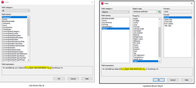

Hi every one,
I have created a dynamic block with Field referencing, my requirement is i want the Same Attribute values repeated in one more attribute, so i have referenced the first attribute values with the Second one ,so when i give value in the first attribute it is updated in the second one as well. the issue i am facing is in this dynamic block when ever i update the block for any minor changes, the Field expression Objid is getting changed, and after making modification when i redefine the block in the drawing i used , my link between the Field is getting lost, and getting error message attached below,
 Obj Id changes
 old and updated block next to each other
in short i want to update all my blocks in the drawing without losing the referenced link between attribute after updating my dynamic block.

If there are not custom values added to any of the attributes, then add the new attribute, make an edit of the existing attributes, then do a regen for the block definition and the fields should return.  You might also consider adding a user parameter to house the desired value and then add a blockplaceholder field referencing that user parameter within each attribute.  Blockplaceholder fields do not tend to lose their connection like object fields.

Attributes will maintain their value through block definition changes unless there is a change to the attribute definition that would reset the attribute to its default state.  Knowing that is useful both so that you can maintain values or so you can force the resetting of values depending on which behavior is desired.  When making edits to the block definition you want to maintain the attribute values of the "FROM_CABLE_NUMBER" attribute so do NOT edit its properties.  In your case, you want to reset the value of the "TO_CABLE_NUMBER" attributes that are in the existing insertions.  This is easily accomplished by going into block editor and making an edit to the "TO_CABLE_NUMBER" attribute so that the existing insertions reset those attributes back to the default value (which will now contain the updated field).  Moving the attribute within block editor will not accomplish that task.  Instead, select the attribute, go to properties and change the Tag property.  Save the block, go to model space, and run ATTSYNC on the block.  If desired, you can then go back to block editor and edit the Tag back to what it was before, save, close, run ATTSYNC again.

Same concept.  In that case, then within your master block definition, make a change to the Tag property of each previously existing attribute that contains a field.  When you redefine the block the existing insertions will adopt the default value of the attributes that have had their Tag properties updated in the master block.  In any case, if you edit any attributes, you will need to run ATTSYNC to update them.
