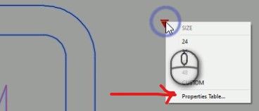

A follow-up question. Can the DB's properties tables row shown below be hidden from the user?
Message 10 of 10
Libbya
in reply to: RocksterB
Nope.
Be aware that clicking the display for the table allows the user to see the table but does not allow any editing of the table.  It is just an alternative way to select the row of the table.  The user needs to enter block editor to actually edit the table values.
