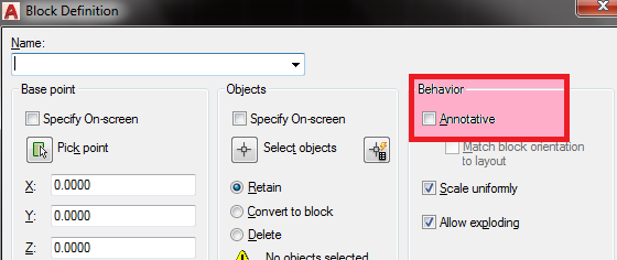

>> 1. Dimension text converts to 1:50 <<
Yes... you can by making Annonative behavior active from block definition (see below image) then add Annonative scale from Properties (Ctrl+1).
