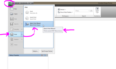

Any reason this built-in tool is not working for you
You'll need to purchase a 3rd party tool if you need a quick fix

I have more than 100.000 files, with different sizes (A0 - A4). Using batch print wizard would take too much of my time. I've looked at reaConverter, which would convert individual dwf files to pdf, but I have certain drawings that are made up of multiple pages in separate files, let's say drawing 00001 has 3 pages - 00001_P1.dwf, 00001_P2.dwf, 00001_P3.dwf. Let's also say that each page is a different format, 00001_P1_A2.dwf, 00001_P2_A3.dwf,... I would like the pdf to be a single file with multiple pages.
