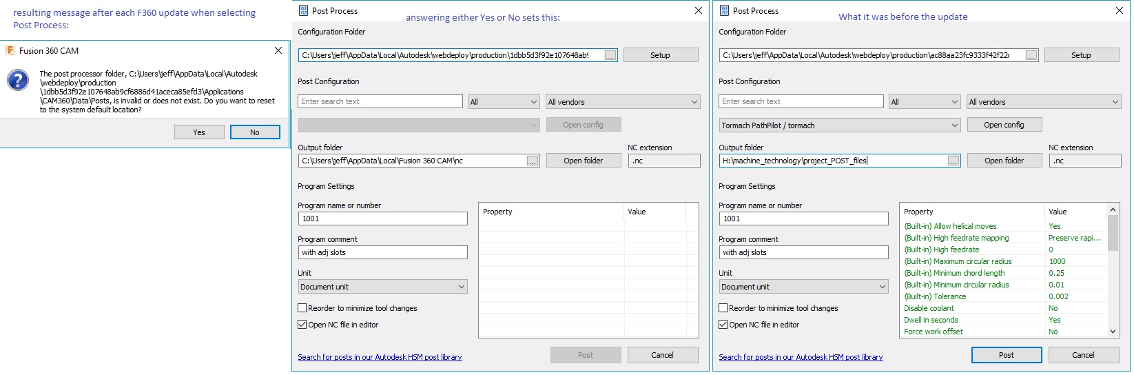

jeff.walters
This happens after an update. The hexadecimal folder name changes so the old path is no longer correct.

jeff.pek
FYI, we'll have a fix for this in an upcoming Fusion update. After that update, you'll probably see that message one more time. After that, we'll store the folder path differently, so that it automatically follows the new location of the "generic" post folder.

Hello, I think I see this identical issue. The attached JPG shows the resulting dialog boxes. After an update, when selecting Post Process, the post directory is set to a non-existent location. Selecting either Yes or No in the box to reset to a default location sets a default location that is not mine. Fix is to manually replace the output folder with my desired output folder. This issue has nothing to do with a particular project. Thanks. Jeff

jeff.pek
I'll take a look at  this; I though this was fixed a long time ago.
  Jeff
Message 10 of 16
jeff.pek
FYI, looks like this was broken again earlier this year to fix another problem.
Will need to reapply the change (while of course avoiding the other problem).
Thanks for pointing this out. CAM-12273.

seth.madore
Select "Yes" so Fusion will locate the correct post processor.
This is an excellent example as to why you should always download and secure your own post processor far away from the generic directory that gets overwritten every time an update rolls out.
