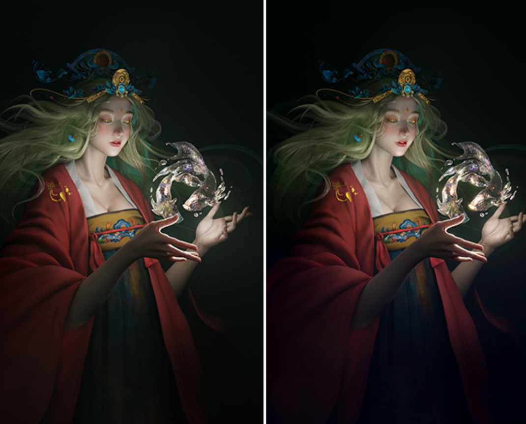

FINAL STEPS
In the fourth week, I focused on fine-tuning lights, fog, and textures, then submitted my first version of the project!
After four intensive weeks, I took a brief break before making final tweaks for the Think Tank Scholarship Competition.
Minor adjustments to hair strands, lighting, textures, and hair shaders brought the project together in the fifth week. I wanted to see how far I could push myself using only 3D tools, limiting post-processing to three specific adjustments in Photoshop: vignette, fog color, and contrast.
(From left to right) First version, Render pre-post, Render with post
