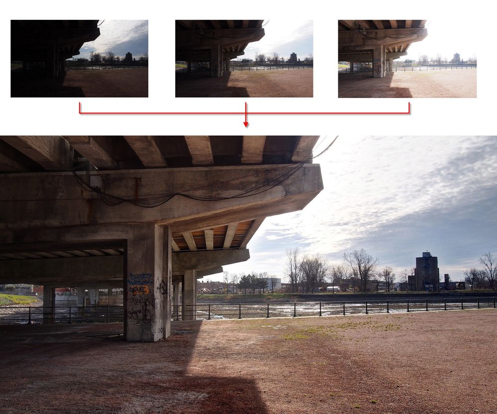

Here’s a situation we’ve all faced at one time or another: You find a spot that you like and you take a picture, only to realize that you can’t see the details as well as you hoped or as well as you see them with your naked eye.
So you figure: Oh well, I’ll just adjust the picture in Photoshop. While this may work for regular photography, it isn’t optimal if you’re planning to use the image for Lighting & Reflection purposes in 3D software.
The trick is to take multiple shots of the scene by varying the speed and aperture (or white balance) of your camera to produce brighter and darker shots. I’ll discuss these techniques in greater detail in a moment, but essentially, you need an underexposed shot to help with the details of the bright areas such as the sky and clouds in this example. However, while the bright areas come into play, the shadow areas get impossibly dark.
So you go the other way and set an overexposed shot. This time, the shadow areas under the bridge display beautifully but the rest of the scene is washed out and the clouds simply disappear.
However, when you combine the three pictures into an HDR image, and use the resulting image in 3D software, you notice that as you adjust the light balance and exposure of your 3D scene, the HDR picture responds much better than your original picture. Certainly the clouds and sky are more visible in the HDR image (and in your renderings), even when it’s dark; while shadow areas are more clear and vivid as the exposure gets brighter. Even glow effects are more natural in HDR photography.
Once you take the same shot of a scene at different exposures (a process known as Bracketing), you can use HDR software to blend them together. Typically, three shots (one normal, one bright and one dark) are enough to get the job done but you can take more pictures by varying the exposure range even further.

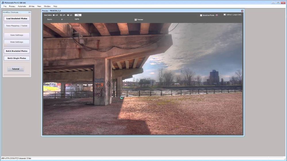

When you google the words: “HDRI software”, you’ll find many applications that can be used to process HDR images. They all work the same way, by blending pictures taken at different exposures. Some of these applications are free; others cost money but most are around the $100 mark. Arguably, the most popular is a $99 program called Photomatix Pro by HDRsoft (http://www.hdrsoft.com), but there are others.
When you load bracketed photos in Photomatix Pro and blend them together, you get to adjust the resulting image by using a process called Tone-Mapping. The resulting image is well-balanced and all areas show the necessary detail, even those that were previously at odds because of high-contrast.
In fact, Photomatix Pro has various processing methods including presets and a multitude of controls to ensure the resulting image is quite to your liking.
However, this procedure is meant to create a resulting beauty shot that is pleasant to look at but that is still essentially saved as an 8-bit picture, which again is not optimal for 3D purposes. These may work well as camera backplates in compositing software but not so much for lighting and reflections in 3D software. For that, you had better save your files in true 32-bit mode to an extension such as .exr or .hdr
In Photomatix Pro, this is an option you choose BEFORE you process your bracketed images, in fact as soon as you load them. The option to show the 32-bit image is disabled by default, so you would need to enable it. This ultimately lets you save a true HDR image in .hdr or .exr formats prior to tone-mapping the solution. Once you tone-map the beauty shot, you lose the ability to save your file to 32-bit format.

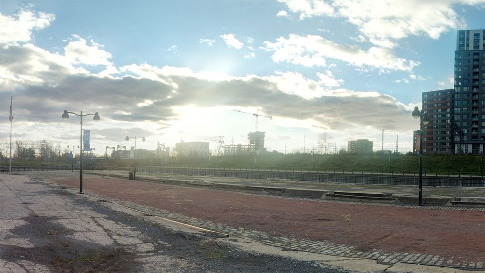

From then on, Hugin analyzes the pictures and finds common control points between them in the areas that overlap. When it’s done, it stitches the images together and reports its findings. If it doesn’t find a good fit, you may need to make manual adjustments to the control points.

Looking at the resulting panorama, you may be wondering about the black and white strip at the bottom of the picture.
This is in fact the pano head and the tripod from the shot with the camera pointing down. I wasn’t too worried about it because I knew there would eventually be 3D geometry that hides this area, adding to the fact that the actual problem area is smaller than it appears in the rectangular panorama. When projected onto a sphere, it’s only a problem when looking straight down.
If it really bothers you and want to eliminate it completely, you can do so by taking more pictures and doing some fancy work with masks in Hugin. What you shouldn’t do though is try to retouch the panorama directly in photoshop. First it would be very difficult to do so because the bottom pixels stretch down to a point, but also because of seams you might mess up by altering the edges.
A nifty workaround is to convert the rectangular panorama into a vertical cross so you can fix the problem area in a way where you can easily use the stamp tool and other Photoshop goodies to replace the pano head with gravel and dirt.
Once that’s done, you can then convert it back to rectangular image to get a clean panorama to use in 3ds Max.

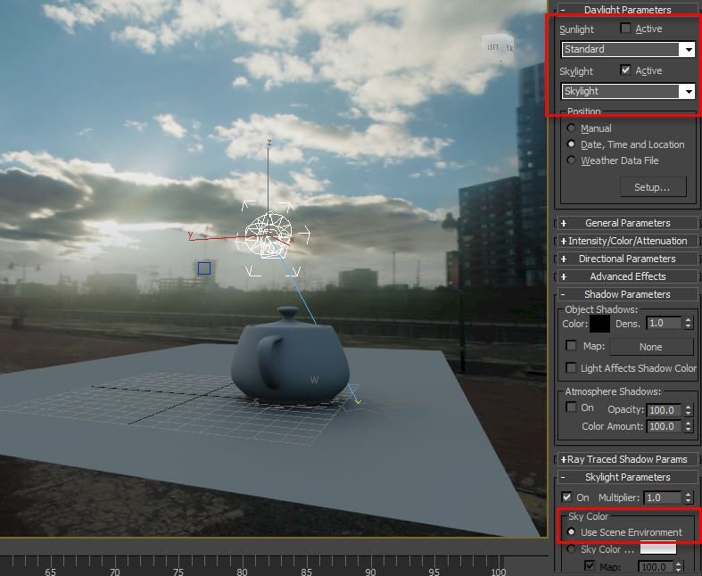

In 3ds Max, I started a new project and made some basic adjustments such as using the mental ray rendering engine and setting up a decent render resolution at 1280x720 pixels.
To setup the panorama, I started by loading it as an Environment Background in the Environment and Effects dialog. To display it in the viewport, I simply set the viewport background to display the current environment used in the scene. Although not always obvious, the background actually needs to be mirrored to be viewed properly. This becomes clear when you view or render an area that contains text.
The reason is that the image is projected on the outside of a virtual sphere, but you’re actually inside the sphere looking out. So, by instancing the environment background into the Material Editor, you can flip it horizontally by specifying a U-Tiling factor of -1
With the background in place, I still needed a light source for the 3D scene, so I used a Daylight System. However, I didn’t let the Daylight System creation drive decisions for me, since it likes to set its own values, (and for that matter its own environment background in the form of mr Sky). Instead, I simply set the time of day to 16:00 or 4pm, which was roughly the time I took the pictures. As for Exposure Control, I set it up to use Physical Camera Exposure Control as this is my preferred method since it was introduced. Here’s the important bit: when using HDR backgrounds you want to enable the option to Process Background and Environment Maps. This makes the background respond to EV changes when setting camera shots.
Typically when dealing with custom backgrounds and especially with Matte/Shadow materials as I had in mind, it helps to adjust the Physical Scale value in the Environment and Effects dialog to help with the process. There may be a bit of trial and error involved but I ended up using a value of 15000.
Watch Video:
It was at that point that I realized that although the sun was present, it was well hidden behind the clouds and was not actually causing any shadows elsewhere in the background image. So I disabled the sun portion of the Daylight System, and set the Skylight to use the Scene Environment. This also had an immediate effect to the overall look in the viewport.
Another quick render to see the results and I was ready for another shot.
