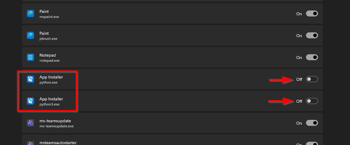

                a. Once Python is installed, you will need to go to the Windows search and type in “Manage app execution aliases”.
     2. When the window opens, find App Installer – Python.exe and App Installer – Python3.exe and turn them off.

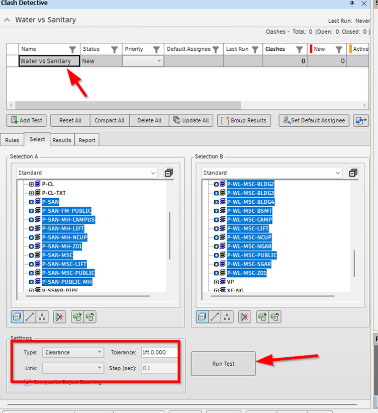

  1. Open Navisworks, create a new model and Append the needed drawings for running the clash detection.
  2. Open the Clash Detective and then click Add Test…
     3. Name your test accordingly. I’m running a clash between the proposed water and proposed sanitary, so the name of my clash will be Water vs Sanitary.
  • Note: Be consistent from this point and name every file the same. You will have different file extensions but keep the same name.
     4. Select your choices on the left side, then select the comparison choices on the right side. In my example, I’m choosing all the proposed sanitary on the left and all the proposed water on the right. Select your clash method. In my example, it is a clearance of 1ft. Anywhere there is a place where the 2 utilities cross, and it’s less than 1ft, that will be considered a clash.
     5. Click Run Test.
If there are no results, kudos. If there are, then we need to export the report. In this example, I have 6 clashes.

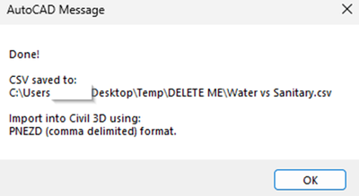

  3. Type in NAVCLASHTOCSV.
  4. When prompted, browse to the XML you saved from Navisworks and click Open.
  5. Now you are prompted to save the CSV file in your preferred location. Remember the naming. This one will be Water vs Sanitary.csv. You will receive a message as shown below…

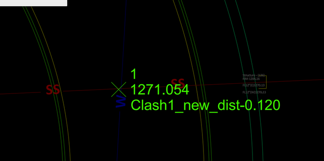

     6. Open your Toolspace and expand Point Groups, and select _All points, right-click and choose Properties…
     7. Choose the appropriate Point Label Style and then click OK…
     8. With _All Points highlighted, in the Item View, select one of the points listed, right-click on it and choose Zoom to…
You can now view each of your points by zooming to them from the Item View in your Toolspace.
