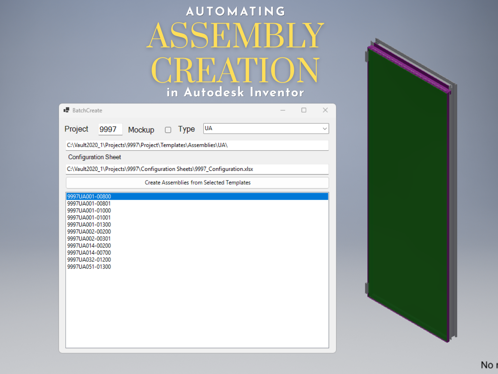

I developed an assembly creation workflow in Autodesk Inventor that automates these processes and reduces the time required to create a unit from approximately 30 minutes to three to five minutes.
Starting With a Configurable Template
The automation begins with a parametric Inventor assembly. Each parametric template uses standardized parameter names that correspond to the dimensions in the wireframe and configuration sheet.

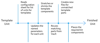

For each unit, the workflow:
  1. Reads the unit information from the configuration sheet.
  2. Updates all named parameters with the dimensions from the configuration sheet.
  3. Rebuilds the assembly.
  4. Evaluates the resulting parts.
  5. Reuses existing components or creates new ones.
  6. Places the required kit components into the assembly based on built-in parameters stored inside the template parts.
  7. Saves the completed assembly.
