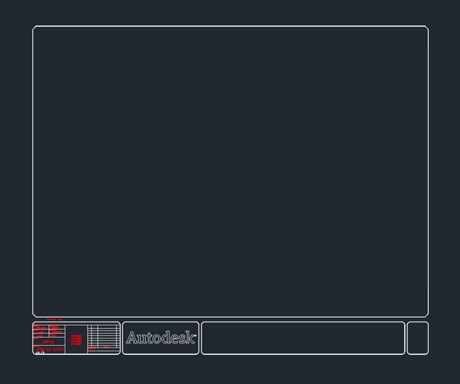

5. Open the exported dwg symbol and make modifications as required.
For Example: We are going to relocate the title bar from right side of the drawing to below the drawing.

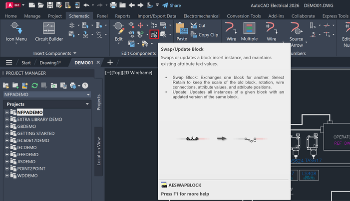

1. Open the drawing in AutoCAD Electrical with your target block.
2. Type AESWAPBLOCK in the command line and press Enter.

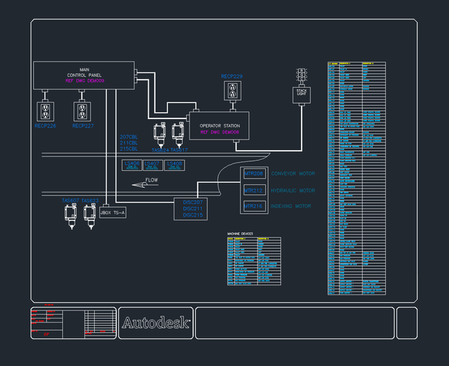

4. Select the block you would like to replace from the active drawing.
For Example: We are going to replace the title block (acade_title) in the image below.

8. The title block is successfully replaced with new version.
