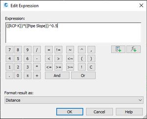

So one night, I decided to tackle this issue and stayed up all night to try to figure out how to automate this process.  Most engineers and designers right now are using mtext or a basic pipe label to add the hydraulic data. This manually typing in your hydraulic data for each pipe segment can be a tedious task, which most don't enjoy.  For those engineers that perform hydraulics, knows that Civil 3D lacks the hydraulic engineering formulas to perform this task within the pipe labels properties. So I basically had to break down the Mannings Equation to its simplest math equations with expressions.  Below are 9 simples steps on how to create you full flow hydraulic pipe label.

Step 4:  Create K Expression
Step 5: Create Friction Slope Expression
Step 6: Create Full Flow Velocity Expression

Then the final step, create a pipe label style, and in the Text Component Editor, Properties Tab, all the expression that you created are now available to be used. To make all the expression work, you just need to add the stormwater drainage flowrate within the pipe properties of each pipe.
