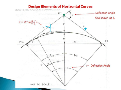

I don't see why you couldn't do it with basic horizontal curves, though (assuming we are describing the same situation). You would just use the PI as the origin of the UCS even though the overall alignment never intersects the PI, only the tangent lines intersect at the PI. See Fig. 1 below for an example.
Fig. 1: UCS would be placed at PI (circled in green) such that the x-axis is aligned with T_x and the y-axis is aligned with T_y.
Maybe we are talking about different scenarios, or maybe you know something else about the limitations of UCSs that I have yet to discover.
