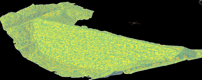

BTW, to show the results from the implementation I did, I took a 300k tri drone surface, and copied it and simplified to 30k tris. That is a 10x reduction.
I then ran a volume between the two to see the average variation up and down, as well as average total deviation from original. Here is the results, with simplified one as "proposed" and orig as "base":

You can see how incredibly well the decimation worked, in terms of maintaining the shape of original.
In shaded mode, the two look like this, with super even intermingling of tris:
