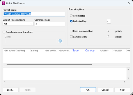

Point File Formats
Point file formats map information in an ASCII file to Civil 3D properties like northing, raw description, etc. ASCII files sometimes contain point attributes; let's have the ability to map these attributes to property sets.

4 Comments
maxime.carrierC5VFZ
Hey Matt, awesome stuff!
This would probably be a bit more complexe than shown (i.e.: entering "just" a property name), since multiple "property sets" can be attached to a single COGO Point, and a simple property name could be reused through multiple property sets, with varying values (i.e.: LegalSurvey:OBJECTID vs. ConstructionSurvey:OBJECTID attached to a single point).
In any case, this should absolutely be a default feature, without having to pass through the API or Dynamo (as I'm doing right now in some land survey scripts).
mathewkol
@maxime.carrierRXTML indeed it would be much more complicated. I didn't feel the need to go into that kind of detail for this. 😊
f_furger
That would be a really cool and very useful thing - I support thi Idea! 😉
