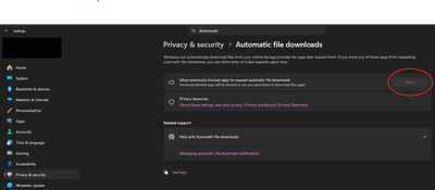

Hello.
I got the solution from my colleague lead.
Just ensure that "allow" button pressed & looks disabled as shown in attached snip named as solution.png
