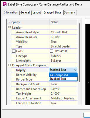

In Autodesk Civil 3D 2026, when dragging or moving the Geometry Label associated with curves (Curves) and manually adjusting its position, the label formatting or data display changes unexpectedly.
When the label is manually moved, it does not maintain the same original formatting, resulting in differences in the order or alignment of the information within the label, even though the Label Style itself has not been modified.
86 Views
hippe013
This is controlled by the Display (As Composed vs Stacked Text) under the Dragged State tab of the Label Style Composer.
Ebraheem20102010
Thank you so much.
It's Done.
