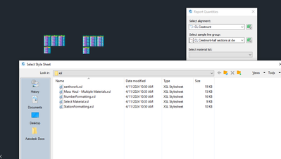

The volume report is not generating. I downloaded .xsl files from Autodesk and it's still not generating reports. I get this message that XML file does not have any style information. This is the message below:
 This XML file does not appear to have any style information associated with it.
The snip is showing all recent .xsl file from Autodesk links. Please help?? It's really annoying issue..

Can you just use the classic command, REPORTSURFACEVOLUME?

In addition to Todd's suggestion, please review the following support article:
Effects of Internet Explorer End of Life on Civil 3D Reporting
