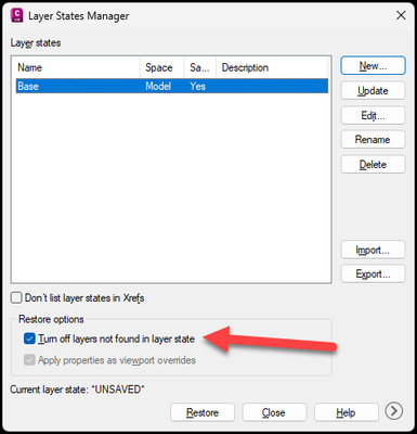

When you import, any layers that are in the layer state will be set to match the layer state. Layers that aren't in the layer state have two options: 1) they will be left alone or 2) they will be turned off.
Additionally (as you can see in that last image just below the setting that the arrow is pointing to), if you are in a viewport, you can restore the layers as viewport overrides, thus not affecting the rest of your drawing.
