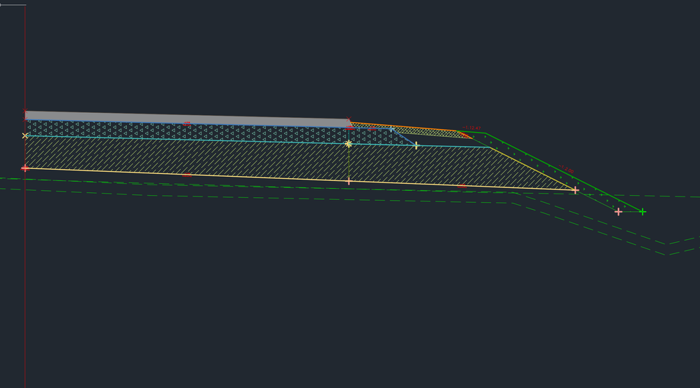

Hi all,
I have two different assemblies (each one includes several custom subassemblies, which have been created in SAC).
I'll be glad to hear that there is a way to use output parameters from first assembly's in the second - i know standart way to use output parameters only inside one assembly with side limitation.
Thanks in advance.

What user really need (Advanced and real workflow)
User need to work with lanes, shoulders, daylights separately. Briefly: at first it is necessary to create and work with lanes and shoulders. Then fix and turn off them. The third step is work with the daylights.
Learn this simple example please:

Unfortunately Civil 3D has a limitation: Inability to use output parameters between different assemblies, so there is a one big problem:
Assemblies (corridor regions) don’t attached to each other on the borders correctly (I create a section view on the superelevation zone – on the spiral of alignment).
My assembly have different grade values on the top and base (20 per mille for Top and 30 per mille for Base as a standard values), so the last layer will be increase thickness from crown to ETW.
I know that user can extract a lot of feature lines and set them as a targets to correct layers thickness as I did earlier (so unconvenient method because all feature lines will overlay on the plan view). Also this assembly need to have permanent grade value on the top and base of all layers from crown to daylight – how I can do this on the superelevation zone – manually in the Section Editor?! So problem already exist. The main goal is to retranslate grade value from one assembly to a different. I try to use add assembly’s offset function – but unfortunately the same limitation…

Yonas89
@Karadzhaian_Eduard,
I'm not a frequent guest to Civil 3D forums lately, so I've just noticed your post and found it interesting. I've also wanted to check an old trick of Civil 3D, and it turns out that  you can actually transfer parameter to different assemblies. At least to the offset assembly. The trick is that Civil 3D takes output parameters from the subassembly by name. So if you have 2 subassemblies in your assemblies collection with the same name, it will always take values from the first one:
In my example I've added LaneLT subassembly to the main assembly and the same subassembly to the offset assembly.
I've also added a ShoulderLT subassembly which is supposed to take a Subgrade grade from the LaneLT subassebly
So on purpose I've changed subgrade grades in both LaneLT subassemblies
I've also made my LaneLT subassembly in offset assembly very tiny in width (1 milimeter), so we can ignore it in the corridor.
And it works. Shoulder LT subassembly takes values from the LaneLT subassembly attached to the main assembly.
