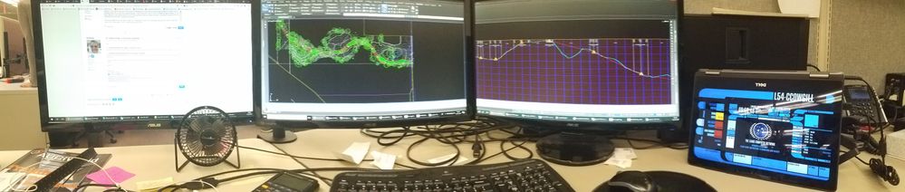

Off Topic:
20171227_095051-1.jpgSmiley Wink

Chris,
So you're the guy with 4 monitors!
I just have one external monitor for my laptop:
